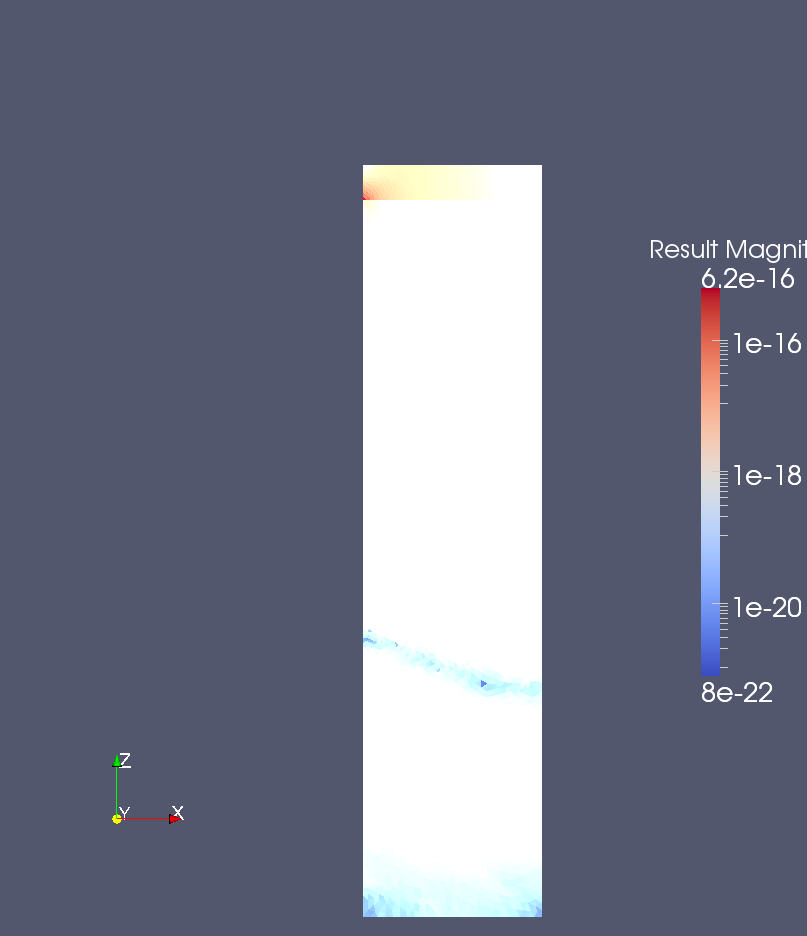

Hi,
I've tested the problem with Pardiso solver (a direct solver) in Intel MKL. See attached results (fracture permeability is 4.1e-8 m2).
Georg, the pressure profile looks good but I'm not sure if accuracy of the velocity is enough for you.
Note that OGS has already supported Pardiso but I needed to change one parameter (iparm[12] = 1) to get the accurate results.
best,
nori

On 02/05/2013 10:36 AM, Norihiro Watanabe wrote:
Hi,
best,
