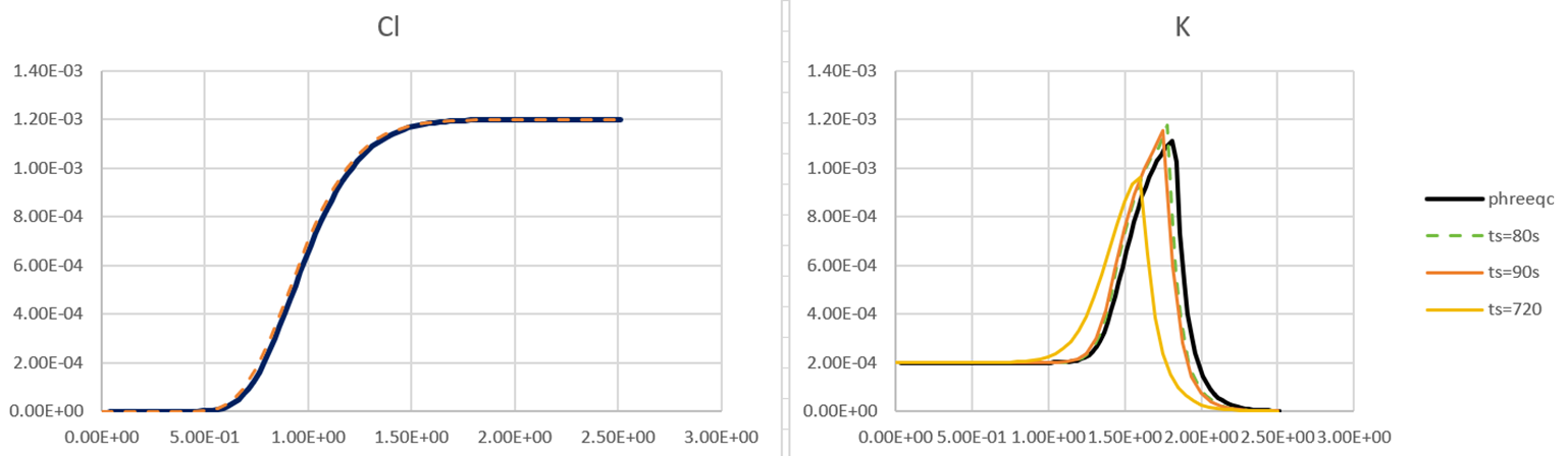

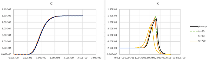

I am currently reproducing the benchmark Transport and Cation Exchange with the original .prj file (no modifications). I encountered two issues and would greatly appreciate any insights:
1. Timestep sensitivity and negative concentration issue :
Non-reactive species (e.g., Cl⁻) are insensitive to the time step, and the results agree well with PHREEQC. Reactive species involved in ion exchange (e.g., K⁺) show strong sensitivity to the time step. However, when using small time steps, the simulation may fail due to negative concentrations, and the computation terminates. As a result, I am unable to reproduce the result shown in the benchmark.
Are there recommended strategies to improve stability? The three numerical stabilization methods either have no effect or result in completely incorrect results.
