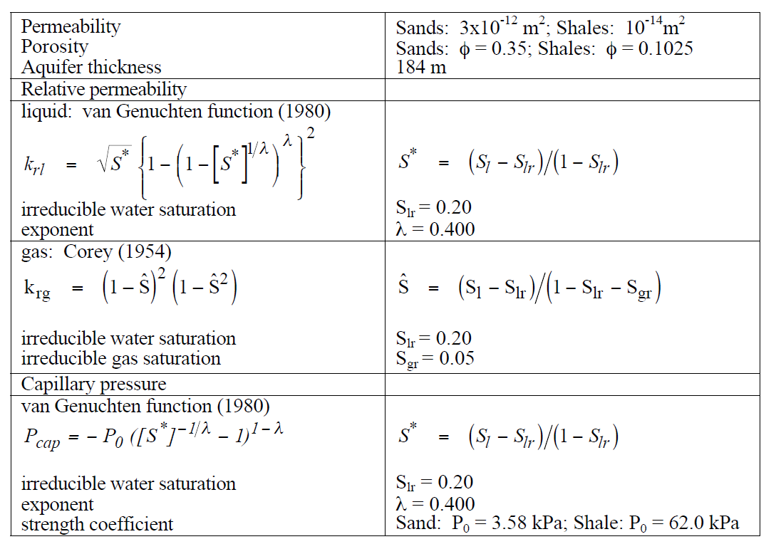

Attached are also the Hydrogeologic Parameters for the case I am doing according to TOUGH Manual
