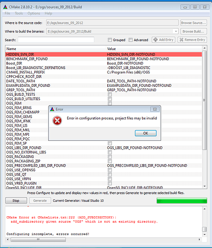

I installed CMAKE 2.8 and I have visual studio 64 installed on my laptop. I am trying to build ogs from the source that I got from Kiel. However, I cannot get past the error in configuration process. I am using Cmake GUI for the build.
I have attached the screenshot of the error. Please help me to figure out what is going on wrong.

I am by far no expert but try to compile OGS in a directory withouth blank spaces. Currently you are using C:/Program Files/OGS or C:/Program Files (x86)/OGS according to your screenshots. Put your sources folder directly under C e.g. like this:
C:/OGS/
and try again.
