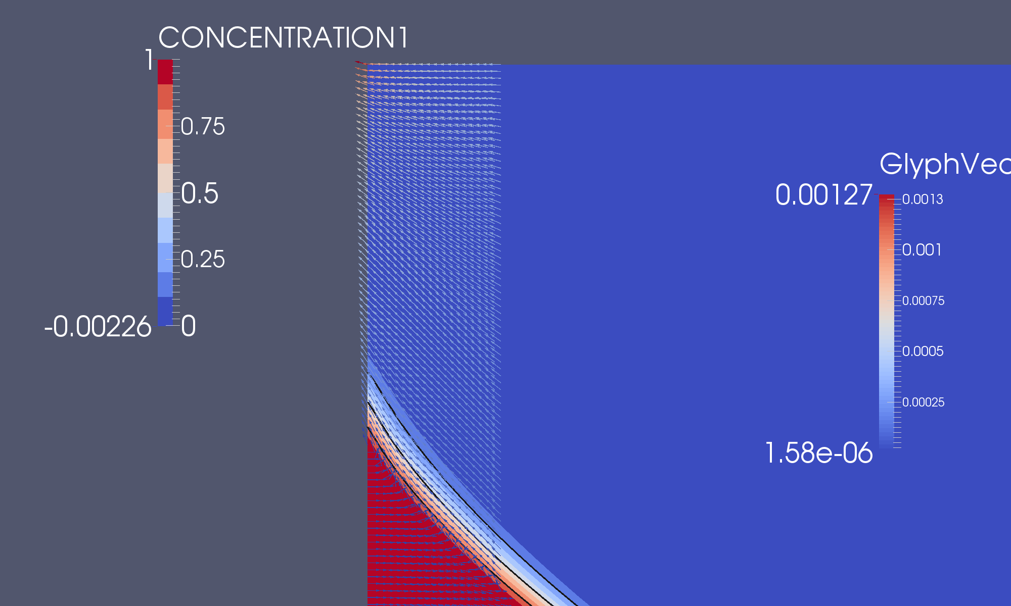

Hi Wenkui,
I was just recently testing a similar condition - enclosed is a picture, where some concentration (bottom of left side) is set to a 1st type BC and getting into the domain with the flow. On top of that, flow is pointing outwards of the domain and the mass BC is deactivated; there, concentration is leaving the domain. Is this, what you are looking for?

Dear Jhonny and Wenjie,
I proposed a solution back then to Wenji, but I don't know if that is what, you need (below my answer back then and enclosed a picture).
Let me know, if you need any assistance in this.

On 23.10.2014 10:12, Marc Walther wrote:
You don't need to define anything for mass transport at your outflow
boundary. It's that simple.
