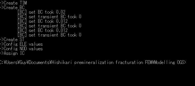

Hi Christoph,
Thank you for the hint. I used OGS 5.7.0 . The simulation could start. But it takes forever to read the .MFP file (see screenshot). When I delete the .MFP file from the directory, it works fine but stops a few seconds later without any error message in the command prompt ( see attached screenshots 1 and 2).
I have also attached a zip file containing all my input files.
Any idea of why this happens?
Just to make my idea clear, I want to model the magma chamber as an incompressible fluid and apply pressure to it as a source term. This should increase the volume and lead to the uplift and deformation of overlying rocks. Maybe I am getting something wrong in the approach?
Thanks in advance!
Best Regards,
Guillaume
Sorry I could not attach the input files. They can be seen via this link:
Best Regards,
Guillaume

Hi Christoph,

Unfortunately I am using windows. I have just retried with all input files but it is stuck again at the same step.

  It's weired. Just tested on my machines again. Even with the debug model executable file,  running to the start of time stepping took  a couple of seconds. If you use Linux, please run dos2unix to all input files.

maybe you should try without $COMPRESSIBILITY part in the MFP file. I
think the keyword is used only for gas phase.

On 03/31/2017 05:47 PM, Guillaume Doudou FAYE wrote:
Yes I used the files in your last email. WIthout the Fluid Properties file
the simulation goes through in few minutes. But ehn the .MFP file was
included it stuck at 'MFPRead' for nearly 30 minutes.

For the 3rd material group of an incompressible and viscous liquid, you
can use treated as hard solid with a relatively large Youngs' modulus.
On 03/31/2017 04:28 PM, Guillaume Doudou FAYE wrote:
I have a problem there. the 3rd material group (material ID 2 in the mesh
file) (the sphere representing a magma chamber) is an incompressible and
viscous liquid. How should I define its properties in the solid properties
files?
The Fluid properties file contains the properties for this material
group.
I tried to run the simulation. It was reading the .MFP file for 30
minutes. I stopped the computation and deleted the . MFP file from the
folder. Now it is running properly. But I guess the results will not be good
until I properly define the material groups and properties.
